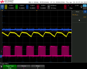

     Regulation issue – yellow is VOUT, blue is the output of the charger circuit VBATT and red is PGOOD:
     PGOOD shows spikes at every peak point of VOUT.

    Here is a plot of VIN in blue, VOUT in yellow and PGOOD in red in the fault condition.
    You can see some noise there - here is an AC coupled plot with an expanded voltage range showing pk-pk of 3.65V around the 20V input.
    Best regards
    Dave
  • Hi Dave,
    I think you see here a lot of noise pickup with the measurement.
    You can try to use the so called tip-barrel measurement method and add the Bandwidth limit of the scope to make this measurement better.
    But still the 600mV is quite large, can you please try to add some more capacitor on the input side to get the supply more stable.
    Please also check the (combined) ESR of the input capacitors - having something in the range of 10mOhm or less would be good.
    It would also be good to see a picture with the gate drive signal (e.g. LDRV1 and LDRV2 - together with the output voltage and input voltage)
     Stefan
