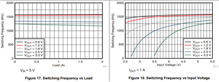

  • Hi Kazuto,
    The typical switching frequency of TLV62568A is 1.5MHz. But as you can see in the datasheet, switching frequency varies slighly depending on the Vin, Vout and Load.
    The adaptive off time control is deisgned in such a way that it will sense the Vin and Vout and based on those values, it adjusts the off-time and will try to keep the switching frequency relatively constant.

  • Hi Sneha,
    Thanks for your explanation. You mentioned "Adaptive off-time technology automatically calculates the OFF-time of HS-FET (or ON-time of LS-FET) ", but the datasheet says different. Which one is true?
    Kazuto
