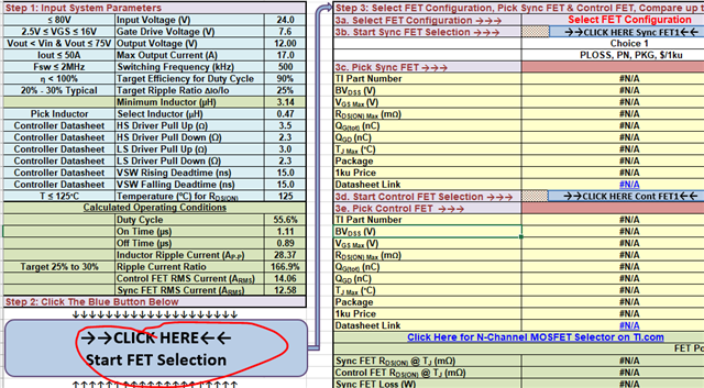

Hi
I can't get any result on the right side after I click red circle,
Is anything wrong?
Hello Fred
Minimum L is 3.14uH but you selected 0.487uH. The tool stops working if a wrong input is entered.
- Eric Lee

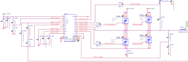

Hi Eric,
below is condition and spec, attached is the MOS datasheet,
Vin=24, vout=12 , TDC=17A , 500KHz
would you help me check if they can use two parallel MOS at high side?
Is there a large switching loss due to large gate charge here (40nC)
Hello Fred
No, you cannot use it. MOFET gate driving current is 60mA (30nC x 4 x 500kHz=60mA) which is twice more than 30mA VCC current limit.
LM5143 is a dual-phase buck controller which is designed to handle high current/high power. And its VCC regulator can handle much more current. Please consider to use LM5143.
- Eric Lee

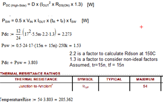

Hello Fred
- Eric Lee
Hi Eric,
1. I see that thermal resistance varies, but based on the existing thermal resistance RJA that datasheet provide , can you help evaluate if the MOS pass the thermal or not?
2. the other question is if I only use one LM5143, is the thermal situation of MOS same as now or still better?
thanks
Fred
Hello Fred
1. What's the maximum ambient temperature ?
2. LM5143 is a dual-channel controller. By using LM5143, you naturally have to design two 2-phase buck and use two high-side MOSFETs. Then, the power loss will be split into those two high-side MOSFETs.
- Eric Lee

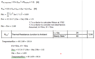

Hi Eric,
thanks for your calculation,
We've change the MOS as below,
the Rds_on is now become 2ohm. the PDC should be 1/4 , which is around 0.56W
As for PSW , the Qg is also drastically reduced , which reduce the tr and tf as well (not sure what the exact number)
through my rough calculation, the Tj is sure below 150C
I believe this can pass with more confidence, would you help check again with new high side MOS?
thanks a lot.
Hi Eric,
again, thanks for the support.
outcome looks OK .
one last question is how did you get 1.3 nonlinear factor and tr and tf ?
like how did you know tr=10ns ?
