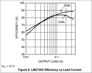

    Can you please confirm on this graphs?
    1. This graph in the datasheet is limited up-to 350 mA output current. But we require 500 mA output at 12V voltage.
    2. Output load current graph shows around up-to 600mA output current at 5V input and 12V output.
    By considering these two different graphs, can you please confirm what is the maximum allowable output current at 12V output voltage and 5V input voltage?
    Thank You,
    Kaushal
  • Hi Kaushal,
    Assume the efficiency is 85% when Vin =5V, Vout=12V, Iout=500mA, the input current is 12V*0.5A/0.85/5V=1.4A. With a proper selected inductance and inductor current ripple is 30%, so inductor peak current is 1.4A*1.15=1.6A.
    LM2735 switch current limit minimum spec is 2.1A, which means it could support 500mA load current application.
    To achieve higher efficiency and better thermal performance, recommend using LM2735Y because its switching frequency is 520kHz.
    For 750mA load current, TLV61048 has better efficiency result and thermal performance.
