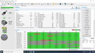

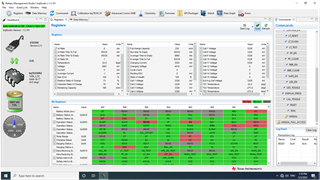

i use BQ78350+BQ76940+BQ76200 design one BMS, i use 10A discharge no problem, when 15A discharge, the BMS protected. The SS, XDSG, AOLDL, AOLD was set, overload during discharge, which is Hardware-Based Protection. Can I disable the function of hardware protection? if not, if i must set BQ76940 PROTECT 2 and PROTECT1 register? I PCBA no I2C interface, if i can set PROTECT2 and PROTECT1 register via BQ78350?
