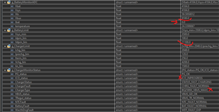

I made my own device with a TM4C123G, BQ25890 and many other components. This board has a USB connector and SD card to log data.
When I plug a charger (Motorola Turbo Charger). BQ25890 detects a MaxCharger device but Ibat never changes (and of course doesn't charge the battery).
Why ICO always is "in progress"? Vindpm is 11.1V but Vbus is 9.1V
Do I need change Vbus to 12V with PUMPX_UP bit in REG09?
With other chargers I don't have problems.
Thanks in advance.
Andrés

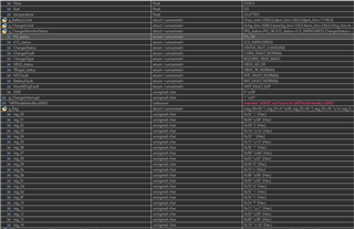

  • Hi Andrés,
    On the BQ25890 when a MaxCharge adapter is detected it will either detect a 12V input or a 9V input. You state Vbus = 9.1V, can you please verify that your adapter (Motorola Turbo Charger) is meant to operate as a 9V source or 12V?
    Additionally can you please provide all register values? The image you include shows some relevant information, but not all.
    Garrett
  • Hi Garrett,
    Best Regards!
    Andrés
  • Hi Andrés,
    Thank you for the additional information. The reason your device is not charging is because the device is in VINDPM due to Vindpm being set = 11.1V and Vbus only = 9.1V. In this condition switching is stopped and the device will not charge.
    The root cause appears to be that the input type detection is not fully compatible with your Motorola Turbo Charger. The adapter handshake is attempting to raise the input voltage up to 12V, hence why Vindpm is set to 11.1V, but the Motorola adapter voltage does not rise up above 9V.
    This previous E2E thread provides additional information explaining how the BQ25890 will not work with all types of HVDCP adapters. https://e2e.ti.com/support/power-management-group/power-management/f/power-management-forum/790857/bq25890-can-maxcharge-be-compatible-with-qc3-0-or-qc2-0
    PUMPX will not work to raise up the adapter voltage, as it is designed for a different protocol. An easy work around is to set FORCE_VINDPM = 1 (REG 0D bit 7) then manually program VINDPM (REG0D bits 6:0) to a value lower than 9V. Once the device is no in VINDPM mode the battery should be able to begin charge.
    Once the device is out of VINDPM the input current optimizer should be able to complete.
    Garrett
