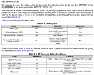

Could you please tell me what the different is between LP standby mode and standby mode? I can't get the answer form below description. The only difference is LDOVINT is disabled in LP standby mode while enabled in standby mode? It seems that VCCA monitoring is different between two mode. What is the difference?

    LP_Standby mode is meant to minimize current consumption to a greater extent than Standby. This is done by disabling the Programmable FSM and only enabling certain internal regulators (LDOVINT remains enabled). In Standby mode, VCCA monitoring is not disabled and continues as in other modes, however LP_Standby disables this monitoring and requires voltage behavior as indicated in the paragraph you provided.
    In order to recover from LP_Standby (this also works for Standby), an On Request must be submitted which is described in the Datasheet as below. During recovery, registers are reset, EEPROM is read to static register values, and the device re-enters the PFSM via the INIT state. By comparison, in Standby, the device PFSM and static registers will persist and the device will simply behave as indicated in the 'Standby' state.
    Additionally, thermal monitoring is disabled when in LP_Standby
    I will look into the reason for 9.1a and 9.1b being absent from the datasheet.

    My customer uses TPS65941213-Q1 & LP876411B4-Q1 to power J721E. Now they need to compute the low power mode current. Currently they only give our VCCA=VIO=PVIN=3.3V. Could you please tell me what the status of our device is now, standby mode or LP standby mode?

  • Hi Sherry,
    When  TPS65941213-Q1 ENABLE is set low both TPS65941213-Q1 & LP876411B4-Q1 devices are in STANDBY mode and LP876411B4-Q1 current consumption is typically 34 µA. LP_STANDBY mode cannot be used (refer to errata https://www.ti.com/lit/er/slvz025/slvz025.pdf).
    VIO voltage is not affecting device STANDBY current so it can be either 0 V or 3.3 V. In a system level this VIO current is taken from somewhere so there is affects.
    J721E PMIC's User's guide https://www.ti.com/lit/pdf/slvucf3  describes more in details different operation states.
