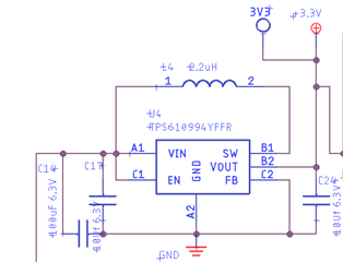

I'm using TPS61094 as a boost power supply to deliver 3.3V.
I've noticed an output voltage instability : 3.3V, going up to 4, 4.5 and even 5V.
After very long trail I found that the the output voltage increment is related the direct light (not heat!!)  that the component exposed to.
In the attached video you can see the shadow of the screwdriver falls on the TPS61094, and how it affects on the output voltage.
I can reproduce the phenomenon in the Lab by using a flashlight.
https://photos.app.goo.gl/P924ZJy1PdCSy85S9
Any idea??
