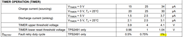

    Plim is currently calculated to be 61.7W, and at page 16 of the datasheet is said "The TPS2491 automatically initiates a restart after a fault has caused it to turn off Q1. Internal control circuits use CT to count 16 cycles before re-enabling Q1". So for TPS2491 which features automatic retry, and in case of a sustained short-circuit, we have a duty of 1/17, 61.7W * 1/17 = 3.6W average power dissipated on the transistor. [I can be wrong with my statement].

  • Hi Jeferson,
    The TIMER has a 1:10 charge-to-discharge current ratio so, the duty cycle is 1% max and not 1/17. The average power dissipation is 0.617W for power limit of 61.7W
    Other option is to use latch-off variant.
    The approach you mentioned with microcontroller is fine.

  • Thanks very much Rakesh.
    Could you please check if the calculations below are correct?
    Tfault = Ctimer * 4V / 25uA
    Tfault = 0.15uF * 4V / 25uA
    Tfault = (0.15*10^-6) * 4 / (25*10^-6)
    Tfault = 24ms
    D Retry - Fault retry duty cycle
    - 0.5% min (200x) - T retry Max = ~4.8s
    - 0.75% typ (133x) - T retry Typ = ~3.2s
    - 1% max (100x) - T retry Min = ~2.4s
    Regards.
  • Hi Jeferson,
    Your calculations are correct.
    Rakesh

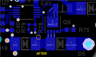

    I'm done, could you check below if you see any problem?
    FINAL SCHEMATIC:
    PCB LAYOUT:
    CALCULATIONS:

  • Hi Jeferson,
    The calculations, schematic and layout looks good to me.
    Have you verified the SOA margin of the design using design calculator? Please check once and proceed. The design tool is available at
    https://www.ti.com/lit/zip/slvc033
    Rakesh
