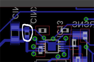

    Below are some layout images you asked for.
    Thank you so much for your input!
    Nejc
  • Hi Nejc,
    Is this the switch node? This seems a bit large especially if it's spanning multiple layers. It could be picking up some noise. I would prefer the path from the IC to the inductor doesn't use any vias or long traces. The noise you are observing could be the large switch node picking up noise from elsewhere on the PCB.
    Also, we recommend placing the high frequency bypass capacitor as close as possible to the IC to minimize noise problems.
    Andrew
  • Hello Andrew,
    you have correctly identified the trace going from the SW pin to the inductor. Thank you the two pieces of advice. I don't have the option to modify the layout at this point. However, I've tried connecting the SW pin and inductor using a thick wire, soldering another filtering/bypass capacitor directly onto the LM25011A IC's pins and disconnecting everything else on the PCB to eliminate other noise sources. I'm afraid there were no changes. So while this may be beneficial for other reasons, the two suggestions unfortunately don't seem to help in solving this particular problem.
