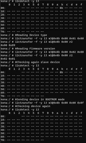

    But when I am initializing BOOTROM mode for Data flashing just after UNSEAL.
    The Slave device just get disappeared from I2C bus. Means there is no slave device showing on SMBUS lines.
    So after sending device into BOOTROM mode device got disappeared and I am not able to flash any data.
    To recover bq20z90 slave device on SMBUS I have to kick start the EVM by disconnecting and connecting power to PACK+ and PACK-
    Now every thing is implemented in code except that device just got disconnected after sending BOOTROM command 0x0F00 to MAC 0x00
    Do you have any idea about this issue.
    Girish

    This is confirmed from my side that device is unable to boot in BOOTROM mode.
    May be during testing via Pro screen I just accidently erase Rom code.
    So device always visible at 0x0b address in Gas Gauge mode when ever I try to send it in Bootrom mode it get disconnected.
    I checked with bqEval Sw and i2c commands, in both case this is happening.

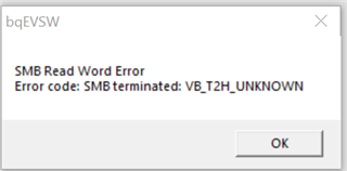

  • Hello Girish,
    The command may not be supported in BOOTROM mode. Try a read word with command 0x0D
  • Hi Shirish,
    As you suggested
    I tried on UI
    Write successfull
    After that reading 0x0D
    Error message
    Girish
  • Hello Girish,
    That is not normal. It could be something with your circuit. Can you check that the bq20z90 is powered when it is not responding?
    I would recommend that you try on the bq20z90 EVM to rule out other factors.
