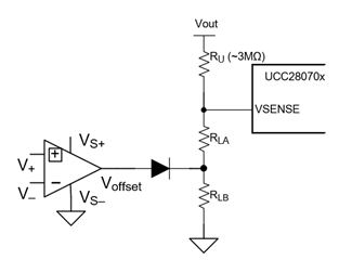

In my current design, the output voltage needs to be adjustable. To do this, the resistor divider for the VSENSE will have its bottom resistor connected to a variable voltage source instead of GND. When this voltage source is zero, the output voltage will be maximum. The resistor dividers for VSENSE and VINAC will be made identical as usual and the normal setup will be valid when the voltage source is zero. As far as I can see, the reason that these resistor dividers are made equal is for the current synthesizer. When the added voltage source is not zero, the current synthesizer will not work properly. However, I will not be using the current synthesizer, and I don't see any reason that this modified arrangement will cause any problems. Is there any other function inside the UCC28070 that would be thrown off by this arrangement?

    I have no experience with using a variable voltage source at the bottom of the output voltage resistor string to adjust the output voltage, but here are a few things that jump out to me:
    - Since the impact of output ripple is higher at low Vout than for high Vout, you'll want to size your output caps and boost inductor based highest transient current at the lowest Vout to avoid unintended OVP
    - While you're adjusting the voltage seen on VSENSE, the OVP and SS are based on fixed voltages (~3V and ~0.7V, resp). You need to make sure you keep these thresholds in mind.
    - Ideally, you want your voltage source to be able to sink current all the way down to zero volts, otherwise, you're going to get voltage offset on your output when it cannot sink enough current to regulate and normally, and ultimately, will result in the bottom resistor being removed from the circuit. You need to consider how this will impact your system.
    - Consider what happens if your offset voltage source fails; the PFC will ultimately trip OVP, but you'll need to make sure the output voltage in that case doesn't take out downstream circuitry.
    - Consider breaking up the lower resistor on on the output string so that you always have a divider on VSENSE to avoid the above conditions when your supply isn't behaving as an ideal source or is disabled completely. Perhaps something like this:

  • Hi Ray,
    Thank you for the points you raised. After thinking about what you said, this is a much better way to vary the output voltage.
  • Ignore the resistor values and the voltage source saying "AC" because it is variable DC (I illustrated using SIMetrix). This way there is always a resistor to circuit common. R3 and V1 could also be replaced with a current source.
    I presume from you answer that if I don't use the current synthesizer (and disable it), no other problems will arise for the internal workings of the UCC28070 if the two resistor dividers are different.

  • Hi John,
    If you disable the synthesizer, the two resistor dividers can be different.
    I will need to verify that 3V is produced by a divider from Vref and will therefore track and is not a separate regulator.
