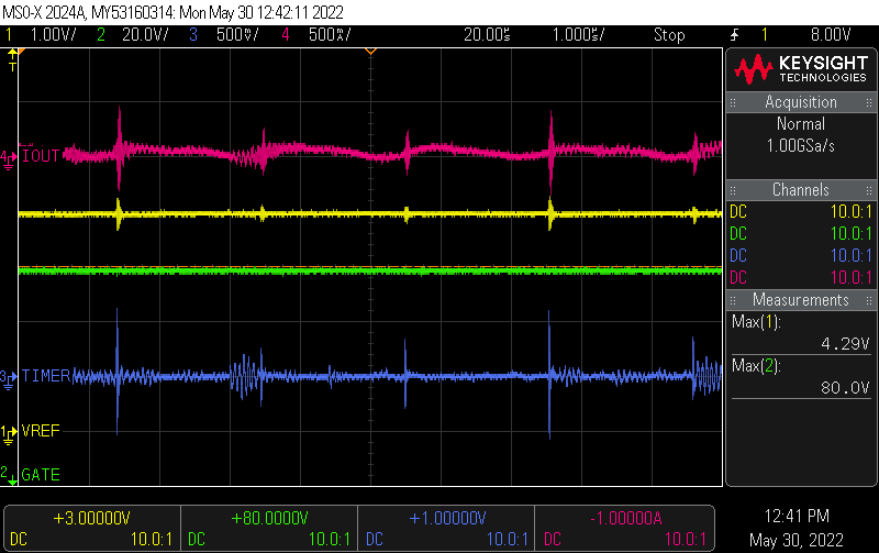

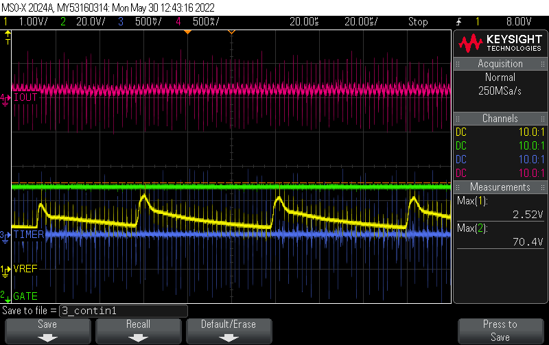

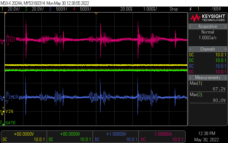

  • Hi Rakesh,
    Thanks for responding; here are the scope shots:
    1. Vin, GATE, Timer, Iout (current probe after MOSFET Q12, not from IMON Pin 6).
    LM5020 in discontinuous mode, when Vref = 4 V and looks normal:
    ...and continuous mode when Vref drops to 1 V
    2. Vout (forget to change the label still says Vin on the scope shots below, but it is Vout), GATE, Timer, Iout (current probe after MOSFET Q12, not from IMON Pin 6).
    Finally, same again but showing Vref as well, when LM5020 in discontinuous mode Vref is a steady 4 V:
    And Vref when LM5020 in continuous mode and Vref becomes unstable (have changed the x scale relative to the other shots to better show what's happening):
