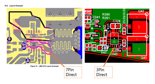

    and here are some questions about layout. Could you check it for me please?
    As you see, layout example in the datasheet shows that VSS thermal pad is connected to other VSS on the TOP layer through no.7 pin.
    But in the customer's layout, VSS thermal pad is connected to other VSS on the TOP layer through no.3 pin.
    We have to confirm that it is okay or might have some problem. (cause they don't have enough time so minimize the risk before they make gerber and real PCB.)
    Please check this issue. Thanks.
    Chase
  • Hi Chase,
    As seen in the datasheet layout example, the best way is to have both VSS pins closely connected. In the example, this is done through the pad, and appears to be similarly connected in the customer design. I do not expect any issue with this.
    Daniel W
