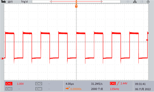

I set debug pin toggle in the fast interrupt. The code is as follow:
fir_index = CimRegs.FIQIVEC.all;
if(fir_index == 27) // Index = N-1 = 26 DPWM
MiscAnalogRegs.GLBIOVAL.bit.ADC_EXT_TRIG_IO_VALUE ^= 1;
Dpwm3Regs.DPWMINT.bit.PRD_INT_EN = 1; //clear interrupt flag
But I found that the debug pin toggle time is not 6.25*4 = 25us and it is about 4us. The switch frequency is 160KHz. why? In detasheet, the switching cycles is not the switch frequency?
  • I agree that it doesn't make any sense.  I've certainly never seen any issue with this hardware function in my many years of working with the UCD.  The most likely cause is that some other DPWM3 interrupt is enabled, like a fault, for instance.
    If you have multiple things enable on the DPWM3, you should look at the individual bits in the interrupt register to decide which is causing the interrupt.  If you're testing on an open loop board, it's easy for the inputs to float to a fault condtion.
