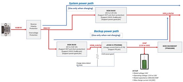

Customers have inquiries about eFUSE recommendations.
Please recommend eFUSE suitable for the requirements below.
1. eFUSE IC
. Design review first with TPS25940 (If there is a low-cost eFuse that meets the specifications below, please recommend it.)
. PG pin support required to determine whether VCAP is fully buffered
. Support required for current limit of at least 1A
. No OVP function required.
. Low In/out Iq
Please check. Thank you.
