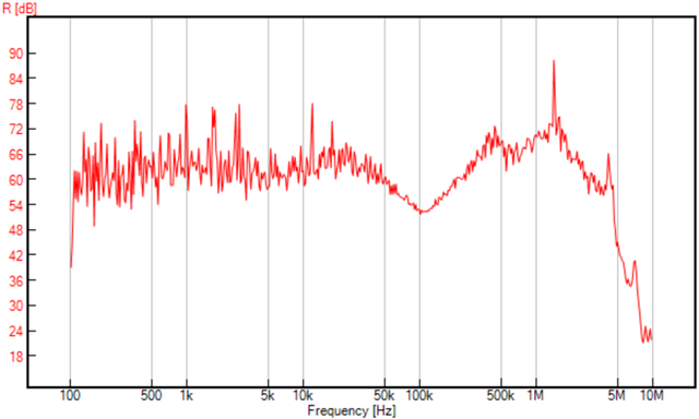

When the PSRR of TPS7B84-Q1 was measured, the following results were obtained.
This does not match the data sheet. What could be the cause?
The measurement setup and circuit conditions are as follows.
Vin=13.5V, Vout=5.0V, Vripple≈100mV, Cin=10μF, Cout=1μF

  • Hi Nick,
    Thank you for your advice. I removed Cin and measured again under the following conditions.
    Vin=13.5V, Vout=5.0V, Vripple≈100mVCout=10μF, Iout=100mA
    However, the behavior between 5kHz and 500kHz still does not match the data sheet. Are there any other possible factors? (It seems that it is the S/N ratio limit of the oscillator that the gain drops sharply toward 10MHz.)

  • Hi Nick,
    A resistive load means like an electronic load in constant resistance mode?
    I tried with smaller Vripple, but there was no significant change in the waveform. There is a noticeable decrease in gain around 100kHz.

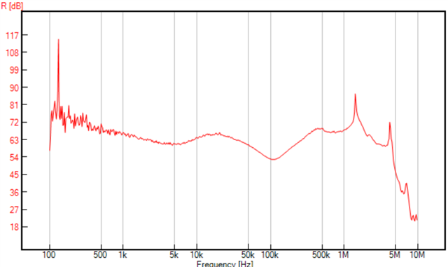

  • Hi Nick,
    Here is the result that I measured with a resistor, not e-load.
    Vin=13.5V, Vout=5.0V, Vripple≈100mVCout=10μF, Iout=100mA (with a resistor)
    Compared to the previous result with e-load, there isn't significant change.
    I also tried 10mV ripple, but the waveform does not seem to change except for some noise.
    Vin=13.5V, Vout=5.0V, Vripple≈10mVCout=10μF, Iout=100mA (with a resistor)
    What I care most about is the drop at 100kHz. I think this part is unlikely to change even if the parasitic inductance is differed. What do you think this is due to?
