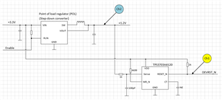

    Below you find the schematics:
    and the scope screenshoot with ch1 = 1.2V and ch2 = Reset output
    Andreas N.
  • Hi Andreas,
    Yes, I meant tSD + tD*(1+/-30%) .
    Yes the 450us does not add additional delay at start up.
    Is it possible if you can put a pull up resistor on the CT pin, just to double check that timing?
    Jesse
