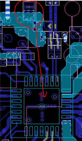

would you help check if our layout has any serious placement or routing problem
below is the schematic (PUA801)
red circle is AGND pin

Hi Pengzhao,
the connection of AGND and PGND is little far from thermal pad shown below, about 300mil
is that a issue?

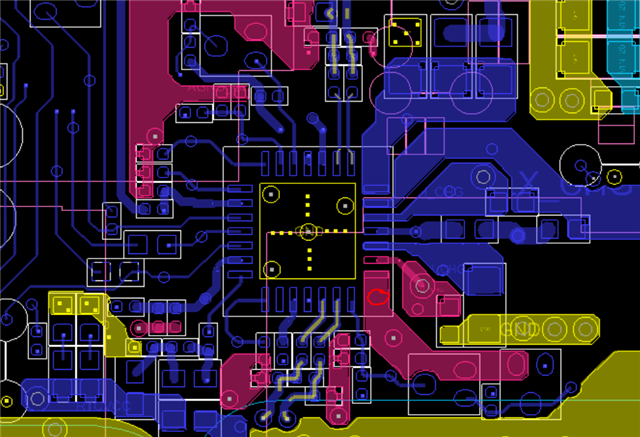

Hi Fred,
I don't see any copper under the IC power pad? It is better to have copper under the IC power pad for better thermal performance.
For AGND and PGND, we kept them separated on the EVM but have a narrow net-tie connecting them right next to the IC. Please see attached images below.
We recommend referring to the EVM as much as possible.

Hi
there're vias on the thermal pad so there must be a copper,
BTW, would you elaborate what would happen if the PGND AGND connection is far from thermal pad?
Hi Fred,
Can you show where they made the connection between AGND and PGND? Please highlight AGND, PGND, and the connection between the 2.
Pin 22 is AGND and we recommend connecting it to power ground through the pad underneath the IC.

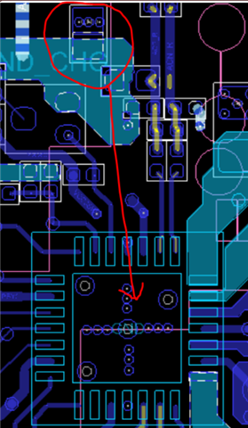

Hi
I already show you before..., see red circle ( above is PGND ,below is AGND)
I know what datasheet said , but I simply curious what would happen if the connection is not below the pad?
thanks
Hi, Fred,
Based on our past experience, the charger will operate just fine, however, the regulation accuracy may be slightly worse, for example, by 1%. This is caused by the layout ground offset.
Tiger
