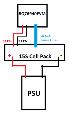

We are using the BQ76940EVM as a cell monitor for a 15S Pack we are cycling. (Please find attached a block drawing of our set-up for additional context)
Would it be possible to make use of the cell balancing features with our current set-up?
If so, what would be the conditions to enable the BQ76940 AFE internal and external balancing features?
Would you also please confirm which FETs on the EVM are used for the higher current external balancing?

  • Hi Matt,
    Could you please clarify what are the conditions required for balancing to be enabled via the 78350?
    Based on the TRM, as you mentioned, we expected it be enabled by default and we tried to observe the underlying behavior in the two following ways:
    - querying the AFEConfig (0x59) via SBS while connected to the SMBus port
    - observing the registers with the BQ769x0 eval software while connected to the I2C port with a EV2400.
    In both cases, we were charging an unbalanced pack externally (image of our setup attached below) and did not see any of the cell balancing registers toggle. In both instances, we were able to see changes in cell voltages via both SMBus and I2C while charging.
    Is it a requirement for charging to happen through the BQ board in order for cell balancing to be enabled? E.g. are there certain hardware connections the board is looking for and/or settings that need to be configured?
  • Hey Patrick,
    Make sure your Cell Balance Threshold and Cell Balance Min are set appropriately for your application.
    Charging current needs to flow through the BQ sense resistor so that the device knows you are charging. The device can see a changing voltage on the cells while charging externally and may not want to balance. Try depleting the cells and leaving it idle (no charging or discharging) to see if balancing occurs after a while.
    Caleb.

  • Hey Patrick,
    On the EVM, R3 is the sense resistor. The schematic is in the EVM user guide. Yes, the gauge can perform balancing while the device is idle or charging.
    Caleb

  • Hey Patrick,
    The BQ78350 needs to measure the charging current to enable cell balancing.
    Can you make sure that all the conditions are met for balancing and then click "start log" in BQStudio. The log file contains a lot of information that will help me debug the situation. Can you also export all of your register settings by clicking "export" on the data memory screen.
