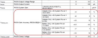

(1). PMON Output current is max 100uA as below Electrical Characteristics, and also If Apmon is 1uA/100W, 100uA=100W.

    3. In the datasheet, the system power monitor accuracy (PMON) has a value of +/-5%, this is the value used for Hybrid boost mode.

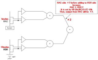

    Thank you for your kindness reply. We checked the above sheet. However,I could not know about I wanted to know.
    I would like to understand the mechanism of the PMON correctly.
    Below diagram is our understand now. Is it correct ? Please teach it is correct, or incorrect.
    If incorrect, please teach the correct mechanism.
    Mechanism of our understand now:
    When RAC 5mohm/RSR 10mohm, 5mohm occurred voltage is 1/2.
    Therefore set 0x3B[13:12]=10b. As the result, RAC side power is doubled by Gain×2 , then RAC side (Adapter) power is added to RSR side (Battery discharge) power.
    Best regards.

  • Hello Norimichi,
    For specific mechanism questions, please contact your local office, they will be able to answer your questions in further details. Thank you

  • Hello Norimichi,
    1. The max 100uA/3.3V spec is not allowed to exceed for a short or long moment.
    2. and 3. PMON Accuracy is specifics in the EC table. As you have attached above. Light load and heavy load is referred to system power. 9W is light load and 45W is heavy load, follow the accuracy spec shown for light and heavy load accuracy differences for adapter only and battery only.
    4. As per the hybrid boost mode equation denoted above, you can estimate the values below. It is within the 5% heavy load range.
        a. (230W×1.04 +  50W×1.045) / (230W+50W) = 104.197%
        b.  (230W×1.04 +  100W×1.045) / (230W+100W) = 104.151%
        c.  (230W×1.04 +  150W×1.045) / (230W+150W) = 104.089%
    5. PMON output current accuracy is not specified in the datasheet, we do not have a spec/tolerance for this parameter.
    Sincerely,
    Adriana Gonzalez Vega

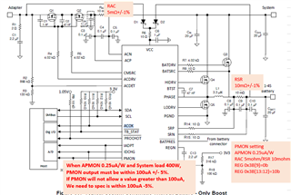

  • Thank you for your help.
    I'm sorry
    >1. Correct, PMON output current cannot exceed 100uA.
    As below diagram, the our system load is exceeded 400W little moment(e.g. 500W), Is it no problem to the charger?
    We would like to confirm that charger is no problem at the below diagram condition just to make sure.
    Of course, we will keep to the pin recommended voltage specifications(SRN/SRP and ACN/ACP) as a precondition.
    (And also, PMON output 100uA max clamp behavior when PMON max is exceeded is good for our system.)
    Best regards
  • Hello Norimichi,
    This will not create a problem to the charger. The statement, even if system load is exceeded from PMON max range, PMON output is clamped 100uA as max, is correct.
    Sincerely,

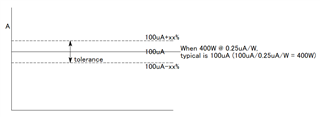

  • I'm sorry, we have the question about below Q&A.
    >Our Question.
    >(3). We would like to check that which is correct below A or B.
    >A. PMON output has posibility that is exceeded 100uA by plus accuracy. eg. 102uA by plus accuracy 2%.
    >B. PMON output is 100uA max even if PMON output has plus accuracy.
    >Your Answer
    >3. Statement B is correct, PMON output is 100uA max, it cannot exceed this value.
    When below diagram condition, if 0.25uA/W max 400W, typical ouput current is 100uA normally.
    But, even if clampted 100uA, we think that the actual output current maybe 100uA + xx% by accuracy by hardware acuuracy etc as the below Diagram No.1.
    [Diagram No.1]
    If keep the max100uA perfectly even if hardware has tolerance, we think that the typical value must be subtracted the amount of tolerance as the below diagram No.2.
    [Diagram No.2]
    What is the correct? Is Diagram No.1 or No.2 correct? Or other is correct?
    If correct answer is not Diagram 1 or 2, Could you explain this reason, please?
  • Hello Norimichi,
    The 100uA maximum still stands, if there is any hardware tolerance, Diagram 2 would be applicable. The device will not allow a value greater than 100uA + tolerance.
    Sincerely,

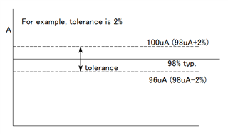

  • Thank you for your reply.
    >The 100uA maximum still stands, if there is any hardware tolerance, Diagram 2 would be applicable. The device will not allow a value greater than 100uA >+ tolerance.
    Could you teach the PMON output actual tolerance of charger, please? We must to know Diagram 2's actual typical value because we will use this function.
  • Hello Norimichi,
    Could you please give more information on the application of this tolerance? Typically, given the spec of 100uA maximum output current for PMON output will allow you to use the PMON function.
    Sincerely,

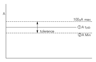

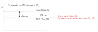

    Our system image is below.
    APMON 0.25uA/W. When System load 400W, PMON output must be within 100uA +/- 5% on our system.
    Therefore, If PMON output will not allow a value greater than 100uA, We need to spec must be within 100uA -5%.
    For example, Our system can't allow the below case's tolerance because Min value is -10%.
    Therefore, we need to know value that the below diagram's  "① typical." and "② Min" by based on an actual tolerance, If PMON output will not allow a value greater than 100uA.
  • Hello Norimichi,
    Thank you for your patience. I will update you on your request by end of business Wednesday
    Sincerely,
  • Thank you for your reply. I added the red rescription. I'm sorry.
    >Therefore, we need to know value that the below diagram's  "① typical." and "② Min" at 400W @APMON 0.25uA/W by >based on an actual tolerance, If PMON output will not allow a value greater than 100uA.
    Therefore, we need to know value that the below diagram's  "① typical." and "② Min" at 400W @APMON 0.25uA/W by based on an actual tolerance, If PMON output will not allow a value greater than 100uA.

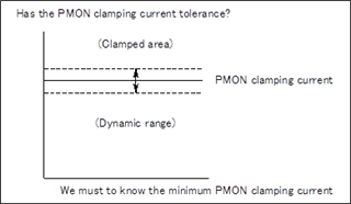

  • Hello Norimichi,
    PMON accuracy and PMON clamping current are two different things. When you hit the clamp current, the accuracy is no longer valid, you could have 10% or 100% error when you reach the max PMON current output.
    Sincerely,
    1. Could you teach the "PMON clamping current"'s accuracy?
        We must to know that PMON is clamped value of most minimum case.(For example 98uA, etc)

    We must to set when 200W or more PMON accuracy within 5%.
  • Hello Norimichi,
    As stated, the PMON clamping current is 100uA with no tolerance.
    The PMON accuracy calculations stated earlier are correct.
    We are working to develop the calculations for total accuracy. Though to mention, small tolerances are already taken into account, if you are using a resistor with high tolerance value, it will need further calculation efforts.
    >why a resistor with high tolerance is used
    1% tolerance RAC and RSR current sense resistor is most low tolerance resistor as the below url normally.
    Welcome to Cyntec - Current Sensing Resistor]
    TI BQ24800 EMI board's RAC and RSR current sense resistor is also 1% tolerance.
    Therefore, we will use the RAC and RSR current sense resistor as most low tolerance 1%.
    On above condition of RAC/RSR tolerance 1%,
    Is "PMON accuracy" as below? Is it correct ?
  • Hello Norimichi,
    PMON accuracy calculations are correct with above condition.
    Sincerely,
