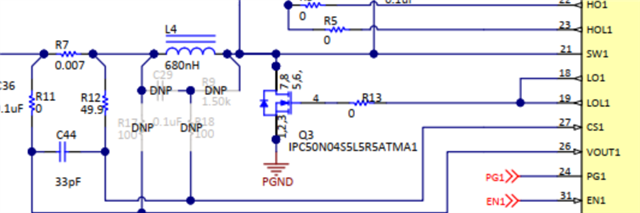

I see EVM and I wonder if you directly use the DCR of the inductor-L4 as a current sampling loop?
please tell the function of R17、R18、C29、R9 beside L4.

Yes, these are components for inductor DCR current sense. The RC across the inductor should match the L/Rdcr time constant.

1.Can you help explain the basic theory of inductor DCR current sense?
2. Which current sense method do you suggest?
Just use the shunt (series current sense resistor) for easiest and accurate implementation. You can use the LM5143 quickstart file to assist with component selection.
For really high-current implementations where the shunt value is less than 2mΩ, you can consider inductor DCR current sensing. Just put an RC across the inductor, where RC = L/Rdcr (pole and zero match). The sense cap is typically set at 100nF, so just choose the R accordingly. I can dig up some links on DCR current sensing if you decide to go this way.
