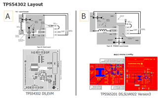

Hi team,
According to AN SLVA922, the layout of Version 3 is optimal.
https://www.ti.com/jp/lit/an/slva922/slva922.pdf
Since the layout of EVM of TPS54302 is close to Version 1, should I change it to Version 3?
The main difference is the position of the input capacitor and how to pull out the SW node.
Which layout is recommended, A or B?
 A (TPS54302 data sheet, EVM)
 B (SLVA922 Version3, TPS565201 data sheet)
