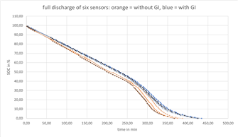

BQ27425-G2A: SOC not linear after writing golden image
Part Number: BQ27425-G2A
Other Parts Discussed in Thread: BQSTUDIO, EV2400
I've got some trouble with the calculated SOC of my BQ27425-G2A: As you see in the picture it's non-linear below a SOC of 50 %. I would expect the SOC to change linear like in the upper 50 %. Also the gauge sets the SOC = 0 % to early at a higher voltage than the setted termination voltage of 3.1 V. The SOC = 0 % is already reached at around 3.45 V at all sensors.
These six sensors were programmed with a golden image before this measurement. The golden image was created with another sensor and bqStudio from which I exported the GMFS file.
During the discharge in the learning cycle I logged the fuel gauge parameters with the EV2400. You can see some of the parameters in the following picture. To my surprise the SOC looks nearly perfect during this measurement before completing the learning cycle.

  • Hello Jackson,
    this took some more time because to my surprise in the next discharge all out of three testet fuel gauges worked fine. You can see the linear SOC in the following picture. Also the SOC was set 0 at a lower voltage which results in a longer runtime. Blue graphs are fuel gauges with written golden image and orange/brown graphs are fuel gauges without my golden image.
    Two of the praphs without golden image look exactly like the graphs from my last post. Maybe something went wrong with writing the golden image last time?
    I did another discharge with the same sensors from the last picture. Before starting the discharge I disconnected the batteries. Then I reconnected them and fully charged all sensors. Here's the SOC-graph from the following discharge:
    Now all sensors have the same nonlinear behaviour. But the sensors with written golden image still have a longer runtime because the fuel gauge sets the SOC = 0 % at a lower voltage then the sensors without written golden image. I read the registers of the golden image and noticed changes in register 52 (hex) offset 1 and register 56 (hex) offset 0. But these registers also had changed after the first discharge with linear SOC. The rest of the registers remained unchanged even after battery disconnect.

  • Hi Felix,
    For this device, upon battery removal, all settings will be restored to default values. This means that upon power loss, you will essentially lose the golden image programmed to the gauge. This is almost certainly the reason for the nonlinear behavior in the second picture.
    The best way to handle this is to program the EEPROM according to the following article. https://www.ti.com/lit/an/slua642/slua642.pdf?ts=1657740496199&ref_url=https%253A%252F%252Fwww.ti.com%252Fproduct%252FBQ27425-G2A. If you configure the EEPROM with your golden image settings, the device will reset to your base golden image upon power removal rather than its programmed defaults.
    For new Golden Images, I would do this when selecting a new battery or when changing the PCB. The gauge will learn the small manufacturing differences from cell to cell of same or different lots.
    For #5, I would just make sure you set any parameters related to Valid Charge Termination such that you will terminate charge right as charging should be completed. I don't think this is the root cause of the non-liner behavior though.

  • Hello Jackson,
    the aim of my last test (disconnect the battery and repeat the discharge) was to figure out if the fuel gauge keeps the written golden image after a power loss. As described I read all golden image registers on the fuel gauge before and after disconnecting the battery and only register 56(hex)/86(dec) offset 0 changed at all sensors. Register 52(hex)/82(dec) offset 1 changed at one sensor. All other registers remained unchanged. Even the Ra-tables in register 58(hex)/88(dec) still match with the golden image. Also the runtime showed a significant difference between sensors with and without previously written golden image.
    Is register 56(hex)/86(dec) the only reason that the fuel gauge needs a new copy of the golden image after power loss? What information does this register contain?
    Would be writing only this register instead of a full golden image sufficient? If the batterys impedance and capacity changes ofer its lifetime I excpect the Ra-tables and Qmax in the fuel gauge to adapt. So after a power loss keeping these learned values instead of writing the values of a new battery seems better to me. Also less memory is needed.

  • Hi Felix,
    register 56(hex) stores the value for load select (Average I Last Run) which is used for calculating RemCap(), FCC(), and in turn FCC(). I am not sure why this is updating when you reset the device but it (in combination with your Ra table values) is definitely what is causing the issue. Can you send me your .gg file so I can take a look at your Ra table values?

  • Hi Frederik,
    have you tried subsequent chg/dsg cycles after the first one following a reset? It appears that Average I Last Run (what I believe to be this issue here) is in RAM and therefore resets on POR. However, I would think that Average I Last Run would be updated after one cycle and I would be interested to see if this solves the non-linearity of the SOC curve. In general, on a POR the device should reset to its GI settings. But I think that the value of Average I Last Run may be different from the current you are actually observing in your application. When you made the Golden Image, did you do a Field QMax Update at the discharge rate of your application? Again, I would like to see what happens on a second chg/dsg cycle and if that improves the linearity of SOC.
    In terms of a battery exchange, I would recommend writing the GI at 100% to avoid confusing the gauge and being able to quickly update all Ra table values with the new cell.

  • Hello Jackson,
    indeed the Average I Last Run is updated after every discharge and varies between devices and cycles. We did two charge-discharge-cycles with three devices after a battery disconnect. During the first cycle all devices showed a nonlinear SOC. In the second cycle two of three devices again showed a nonlinear behaviour. The third device seemed fully learned with a linear SOC. We don't know what caused the difference between the devices because all three were handled the same. Unfortunately we only logged the SOC of the fuel gauges and no other parameters.
    What exactly do you mean by doing a Field Qmax uptate when making the golden image? In the learning cycle we used a discharge rate of C/7.5. Our application has a rate of around C/6.7. Do we have to repeat the discharge with our application-discharge-rate?

  • Hi Felix,
    Adjusting the discharge rate of the third discharge cycle to your application discharge rate (C/6.7) will improve the accuracy of SOC. Because the discharge rate of C/6.7 and C/7.5 are not too drastic, this isn't an absolutely essential step but it will help to improve gauging accuracy. I suspect that the reason that the gauges are becoming more and more linear over discharge cycles is that the gauge is accounting for the slight differences in what is expected from the ChemID and what is in each individual cell. Essentially, the gauge is accounting for all of the slight discrepancies in impedance, FCC, and other parameters from cell to cell. As the gauge does more cycles, it is able to adjust parameters like QMax and FCC to be more and more accurate.
    Hope this clears everything up,
