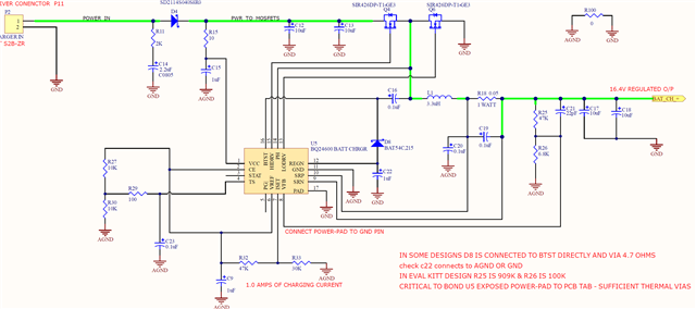

I have a battery charger based off the TI BQ24600 IC. the design is as per the reference design in the specification sheet. I have a 4S1P Li-Ion battery pack with a built in BMS.
schematic diagram attached for references.
I did a few charging tests. (data attached). During charging I measured the temperature of the Charging IC (BQ24600) and the Switching MOSFET (in the main-power-path) I see that after the battery is charged and the charging drops down to 0 (actually shown as 0.3 amps due to measurement faults) the temperature of the Charging IC and the Mosfet does not go down to room-temperature and remains around 60 deg C.

  • Hi Saif,
    Could you provide the PH waveform after the charging is done? Please refer to the datasheet P5, there is a 2mA current typical from the adapter after the charging done (CE=High). Please try to reduce the input voltage to check whether the temperature changes.
    BQ24600 is a buck step-down charger, so the input voltage has to be higher than the battery voltage to get the battery charged.

  • Hi Saif,
    Can you please try disconnecting the input voltage following charge completing?
    It would also be helpful to check the status of the STAT pin and the /PG pin when you observe charge complete to verify the status. It is possible the device could be in battery absent. This will require pullup resistors to evaluate. In addition, you could use the STAT pin with MCU to pull the CE pin low or even disconnect the adapter.
    Last, please provide the PH waveform and SRN waveform after charge has completed.
