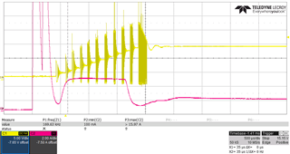

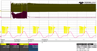

Switch pint and current input prim, turn on
Switch point after 1s

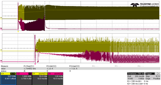

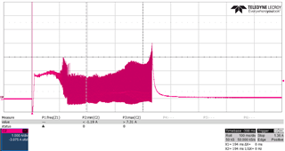

Current input prim 24v, turn on

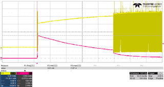

Current input prim, f=3.9kHz

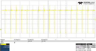

With 2 Ohm in series of the input line, 24V
