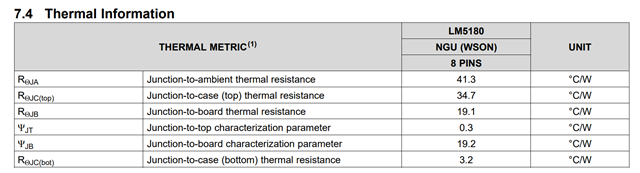

we are using LM5180NGUR part and we require case temperature of given part so please provide this information.

Hi
below is LM5180 thermal information, can you let us know the detailed requirement?
Hi Daniel,
In data sheet given case thermal resistance but we need case temperature vale.
HI Modi:
you ask other two parts in the E2E, you need have a powerloss first which you need specific the input and output condition.
and case temperature is Tcase=Tj-ΨJT *powerloss, Tj=Ta+ThetaJA*Powerloss
