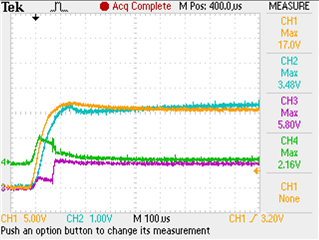

  • Hi Daniel,
    Here are some oscilloscope screen captures:
    In this scenario (which is our intended use-case) I’m just providing around 15 V to VCC2, shorting AI5 and AI6 together and apply around 3.5 V, and leaving VREF with just a bypass capacitor. All measurements relative to GND2. AI2 is shorted to GND2. I checked the DESAT pin and during the start-up transient it never sees more than 0.5 V and is otherwise ~0 V. Not all screenshots have the same time or vertical divisions.
    - 1 -
    CH1 – VCC1
    CH2 – AI5 & AI6
    CH3 – OUTH

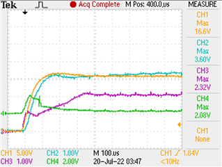

    - 2 -
    I’m including the next few waveforms just in case:
    CH1 – VCC1
    CH2 – AI5 & AI6
    CH3 -- VBST
    CH4 – OUTH

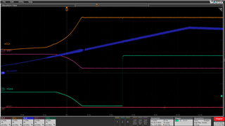

    - 3 -
    CH1 – VCC1
    CH2 – AI5 & AI6
    CH3 – VEE2
    CH4 – OUTH
    VEE2 is clamped to GND2 through a Schottky diode, but it looks like there is a transient that initially takes it above the recommended 0.3 V.

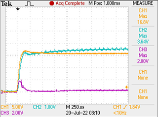

    - 4 -
    CH1 – VCC1
    CH2 – AI5 & AI6
    CH3 – VREG2
    CH4 – OUTH
    I know this is a little different from what I presented before (where VEE2 was powered), but I assume it would work this way as well?
