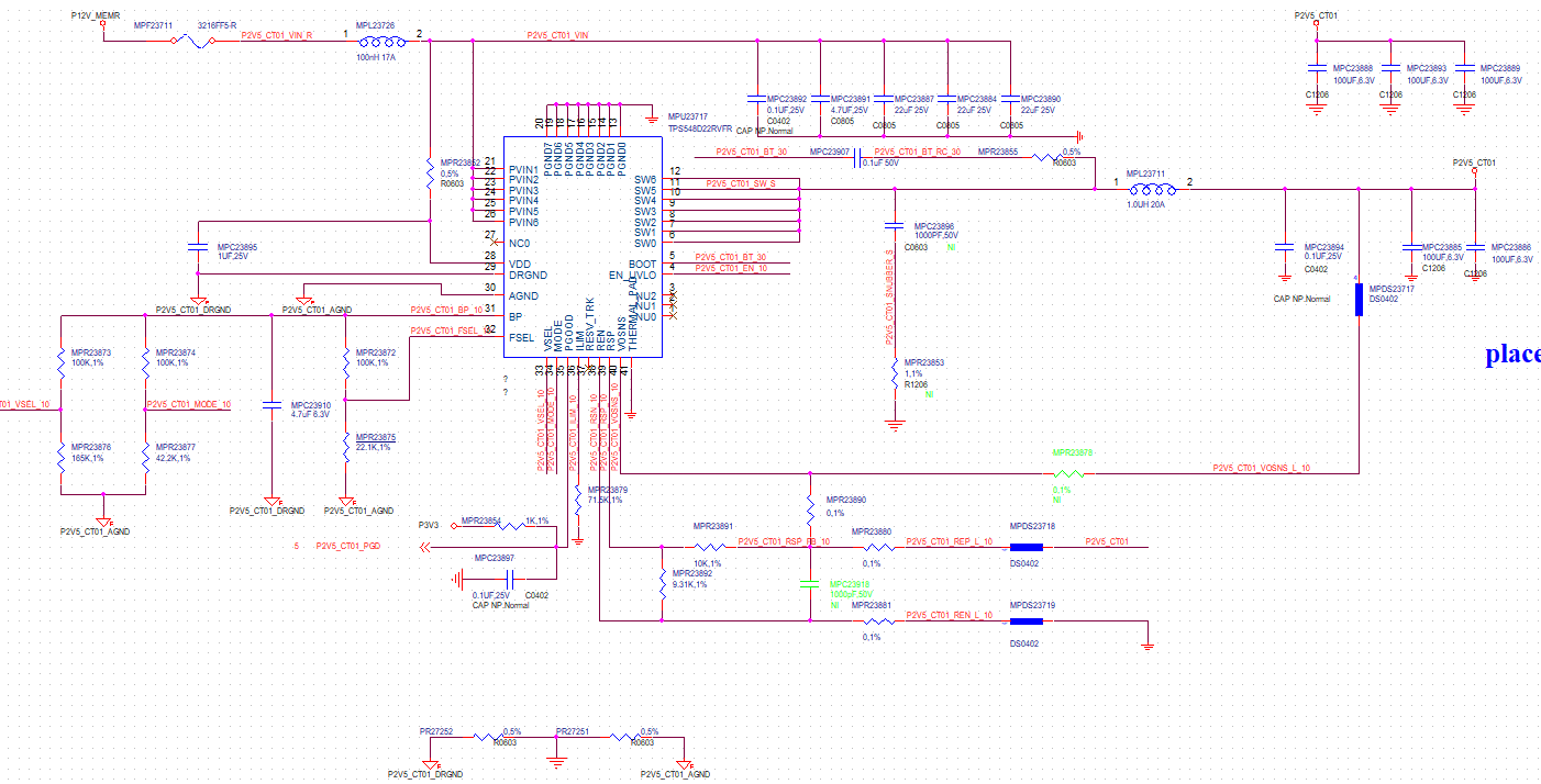

The input is 12 V,and the output is 2.5 V. The transient loading is from 2 A to 10 A. Why the overshoot followed by an undershoot, and the undershoot followed by an overshoot, no matter what the inductor I changed to?

It would help if you could share your schematic. Typically this would be the result of low phase margin in the loop, due to high propagation delay between the output terminal of the inductor and the sensed output voltage, added filtering in the feedback path, or insufficient output capacitance given the Inductor and ramp generator selected. They schematic could help identify which of those is the likely cause.
The circuit appears to be set-up for remote sense. A long power distriibution path with remote capacitance can negatively affect the loop performance by adding a parasitic filter and related delays to the power-path, so I would recommend checking that.
However, if the schematic showin is complete, I would recommend changing the ramp generation resistor from 1x to 3x by changing MPR23875 (FSEL to AGND) from 22.1kΩ to 37.4kΩ.
You may also want to consider adding a 220pF capacitor in parallel with MPR23891 (between VOSNS and RSP) to counter the attenuation of the feedback divider at high frequencies.
Additionally, if you have an issue with a parasitic L-C in the power path to the remote sense point, you could populate a capacitor in the MPR23878 location to form a high-pass filter with MPR23880, though I don't see a value on MPR23880.
