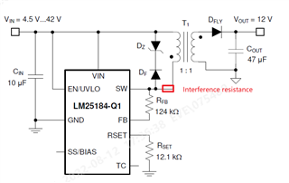

LM25184-Q1: Loop Stability Test
Part Number: LM25184-Q1
Other Parts Discussed in Thread: LM25184

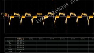

Hi, Ti team, I want to test the performance of the LM25184's loop response. According to past experience, I put the interference injection resistor in series on the voltage feedback loop, but we can't get the correct Bode diagram. The measured waveform is very bad, I don't know Is it a problem with my test method, I hope to get your help, thank you.(Below is a schematic diagram of my resistor locations)
