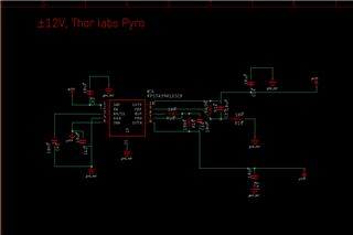

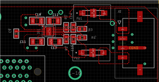

TPS7A39: inconsistent
Part Number: TPS7A39
I'm having a bit of trouble with an LDO specifically TPS7A39. I'm having very inconsistent success in its implementation I have have several failures where the positive side output is the positive supply voltage and the negative output reads close to 0.5V or so.
The problem is compounded by the fact that they operate as expected about 30% of the time so I'm not sure the what is causing the failures
