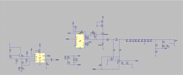

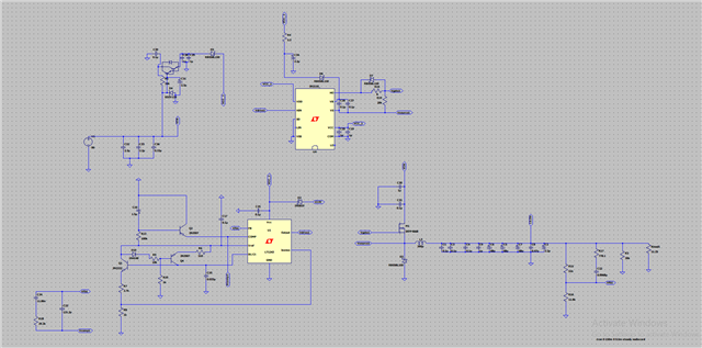

    Another question I have based on my simulation is that I have a high inrush current at start up yet I have soft start implemented. What I am doing at startup is using a linear regulator which I implemented using a Darlington pair to provide vcc to the ic for a short time then tapping the output of the 13.5v buck converter to provide vcc. My reason for doing this is to limit the power dissipation by the linear regulator since it will only be on for a very short time. I am not sure if this is what is causing the soft start not to work. Let me send you a snap shot of the circuit I am simulating.

    I hope that I've help contribute to the original post about current sensing? Keeping the conversation close to the subject thread helps improve the search accuracy for the entire E2E community. Since this topic has shifted from the original post title, I'm going to close it and ask that if additional IC support is needed, you can open a new thread with a thread title related to your inquiry? Thanks for connecting through E2E.
