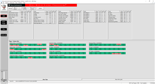

Hello Team,
I have Discharge My battery completely , Below CUV threshold ( Just to Test ( Cell Voltage = 2500mV) ). Before CUV threshold RSOC was showing regularly on charge, but after this discharge RSOC is not increasing above 0%. I tried to charge Cell Voltage = 3450mV. Still RSOC=0%. FD flag is set. Snap shot attached here with.
Can I use FD Clear Voltage TH instead of FD Clear % ? Any parameter Setting ?
    It seems like the gauge did not enter charge mode, for the gauge to enter charge mode, the average current has to be greater than the Chg Current Threshold. I would need to check the log file to further investigate this issue.

    I looked into your gg file, and I see that fixed EDV0 is set to the same voltage level as CUV threshold. Mostly, fixed EDV0 will be configured a little bit higher than CUV threshold unless you want the FETs to turn OFF at 3160 mV.  System will get back into normal operation once one of the cell voltages is higher than the CUV recovery voltage. At this point check if TDA, FD, CUV, XDSG are reset, if those flags are not 0, please check at what voltage level it happens.
    So in your configurations I see:
    fixed EDV 0 = 3160 mV
    CUV threshold  = 3160 mV
    CUV Recovery  = 3250 mV
    I would try setting CUV threshold lower, and then discharge down to fixed EDV0 (to avoid protection from triggering). Then, charge again and see if RSOC makes more sense.
