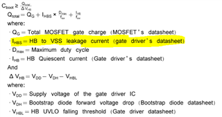

  • Hello Sasikala,
    I am using UCC21750-Q1 driver. In the bootstrap reference document Bootstrap Circuitry Selection for Half Bridge Configurations, there is following term that are not available for 21750.
    e.g. IHB = HB to Vss leakage current.
    The leakage current is for IH or IL i.e. on 5V side (Logic inputs IN+, IN-) mentioned in datasheet.
    Should we consider that current to calculate bootstrap cap value?
  • Hi Abhishek,
    The Cboot should support both the switching current [based on the Gate capacitance] + the device quiescent current max [for the entire period of switching Ton+Toff]
    IHBS is not the IH/IL logic inputs leakage current.  UCC21750's VDD leakage current spec [equivalent to HB Leakage] is not defined in the datasheet.
    If you plan to design biasing the device current [IVDDmax] + Current needed for the External gate capacitance [based on Power Switch gate charge], then it will fulfill your biasing need. Hope it helps.
    Also as recommended in the design, Cboot min >=  10xCg, this should help to design the Cboot.
    I recommend that you do simulations and prototyping for this design in your system to verify that it will function within the driver's limits.
