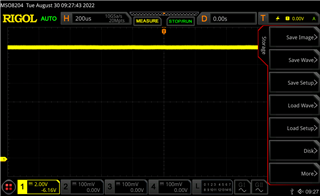

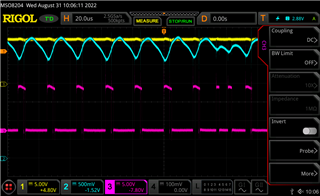

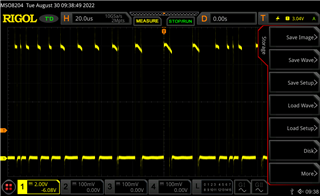

Please see attached schematic.
Input voltage 12V DC
Desired output Voltage 3V DC
Desire Output Current 5-10A
C25 Rubycon 35YXG1000MEFC12.5X25
https://www.rubycon.co.jp/wp-content/uploads/catalog-aluminum/YXG.pdf
C = 100uF
ESR = 89MOHM @ 100KHZ
C26 Kyocera TPSE337M010R0040
https://datasheets.kyocera-avx.com/TPS.pdf
C = 330uF
ESR = 40mOHM
When Powering module even without load coil and transistor driver on the PTH08T220WAD board is getting too hot around 50 degree C, input current around 500mA.
When applying load 1-2.7A device is getting warmer input current goes up to 750 mA.
When loading device with 3A load, we noticed is PTH08T220WAD is going in to shut down (overheat?) mode.
Please advise at your earliest convenience what should be changed to get device operating normally.
