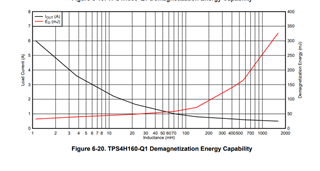

    We didn't quantify the multiple pulses, and with PWM, the heat will be the factor needs to take consideration. The best way is to order an EVM and test with the PWM pulses and see how much thermal margin you have.
    For single pulse, the energy curve for TPS2H160 should be around the same as TPS4H160, which I attach the curve below.
    Please let me know if there are any other questions I can clarify.
    www.ti.com/.../slvae30e.pdf
