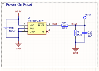

We have a design with a TPS3839 X2SON working close to a 850nm IR source.
We noticed that the RESET line is randomly being pulled low when an IR LED nearby is flashing and there is a reflective surface in front of it, causing the light to bounce back on the IC.
Flashing a high intensity IR torch in front of the IC also causes random resets.
It does not seem to be a EM noise issue, because all the rails and signals are stable when looked on an osciloscope. Also, covering the IC with an IR absorbing putty prevents the resets from occurring.
To me this seems light an undesired photoelectric effect caused by 850nm light of high intensity.
This seems consistent with what was reported in a previous post:
https://e2e.ti.com/support/power-management-group/power-management/f/power-management-forum/580193/tps3839-reset-signal-problem-while-ic-is-being-exposed-to-strong-light?tisearch=e2e-sitesearch&keymatch=TPS3839#
  • Hello Paolo,
    The X2SON package is very small so there is not as much packaging material shielding the silicon die compared to larger packages. The package might be thin enough that some of the IR light at that wavelength can penetrate the package to the die. I would suggest shielding the IC from the IR LED.
    Walter
