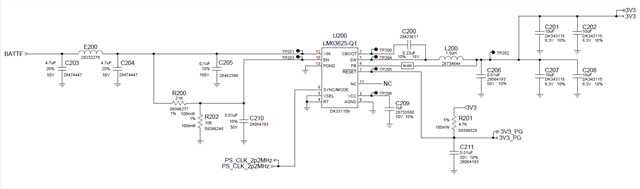

LM63625-Q1: could you please evaluate if LM63635 can P2P replace?
Part Number: LM63625-Q1
Other Parts Discussed in Thread: LM63635-Q1,
Hi Expert,
Our customer design LM63625-Q1 and schematic but they want to use LM63635-q1 with p2p upgrade without any hardware change. Do you have any recommendation for below design? Thanks.
