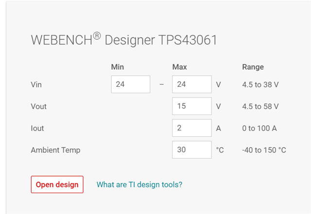

    Customer wants to simulate the efficiency 12V to 28V (500W) or 24V to 48V (500W).
    1. May I ask why there's a limitation on Iout for LM5121 Webench design? As it's a controller, I thought it would be able to drive all power watt as long as FETs are selected correctly.
    It goes similar to TPS43061. There's a limitation of 100A.
    2.  Beside the Iout limitation in Webench simulation, I notice that I cannot get the efficiency data in Webench anyway as below. Please let me know if you have an idea to estimate the efficiency/thermal before customer decides whether two devices are a proper solution or not.
    3. I notice LM5122 Webench simulation works. LM5122 and LM5121 are basically the same device with several differences (disconnection FET and multiphase capability)? Can I consider that the effi of LM5121 would be similar to LM5122?
  • Hi Ella,
    Webench uses a database of components and tries to make a design out of these.
    I do not know all the internals of Webench but how should the system make an useful efficiency calculation if one of the most contributing elements is an ideal component.  Maybe that is the reason why they do not process this.
     Stefan
