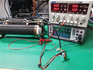

    Testing with the Evaluation Board
    Test Setup
    Photograph of the Test Setup using the TPS62912 Evaluation Board
    • The evaluation board is powered by the TTI bench power supply at 5 Volts.
      • The thick cables from the output connect into input header J1 on the eval board:
        • Pins 1 and 2 (Red +ve)
        • Pins 5 and 6 (Black -ve)
      • The sense output connects to J1 through dedicated sense wires:
        • Pin 3 – Red sense +ve
        • Pin 4 – Black sense -ve
      • The output header, J2, is connected to a variable resistive load (shown in the screenshot) through a Keithley digital multimeter (DMM) configured as an ammeter
        • The red resistive load wire connects to J2 pins 1 and 2
        • The black resistive load wire connects to J2 pins 5 and 6
        • Pins 3 and 4 are not connected to anything
        • The DMM is indicating a 1 Amp load current
      • The oscilloscope connects to J5 (VOUT_FILT) through a 3-foot-long SMA to BNC cable assembly
      • The oscilloscope input is configured as follows:
        • DC 1MΩ input impedance
        • 20 MHz bandwidth limit
      • The Test PCB is configured as per out-of-the-box
        • JP1 has a jumper from pin 1 to pin 2 to enable the power supply
        • JP2 has a jumper hanging off pin 1 to the side, selecting SCONF pulldown of 52.3k
        • JP3 has a jumper fitted to pull PG up to the output 3.3 Volt power supply
        • J3 is not populated with any jumper (I’m not reading in the power good signal)
        • All resistors and capacitors are as came from the factory – we’ve not modified the board in any way
    In response to your questions on my setup:
    • There is nothing else in my setup other than the input supply, the variable resistor, DMM ammeter and the oscilloscope connection to the SMA test point.
    • We are applying one wire of the load to pins 1 and 2 of J2 and the other wire of the load to pins 5 and 6 of J2
      • The Vout sense lines on J2 are not connected to anything
      • We are not loading the sense wires
    • The Vin sense lines on J1 connect directly to the sense input of the bench power supply remote sense terminals
      • We are not powering this board through the sense connections
