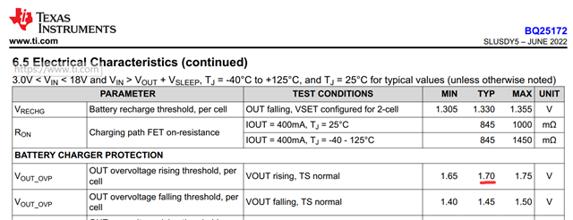

BQ25172: Problem with Vout_ovp
Part Number: BQ25172
Other Parts Discussed in Thread: BQ2002
The typical Vout-ovp is 1.7V, but how does a 1.2V NiMH battery achieve 1.7V to  terminate the charge cycle? The max voltage of battery is around 1.55V, and it still charges the full charged batteries more than 3 hours.
