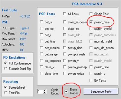

           We use the BT Type-3 to run the sifos test for the at/af ports which use the TPS23881.But there is also the paremeter of Tlim_Max_2 which cannot pass.
    My colleague used the TPS23881 as the AF/AT PSE controller.The switch board could pass the at/af sifos test using the BT Type-3.
           So I think it can solve this problem modifying the software.Can you give some advice to our software engineers.
  • Jingjing,
    During the pwron_maxi test, a short circuit stimulus is applied and the PSE is triggered into foldback mechanism. It seems the foldback is triggering but after the TLIM = 60ms expires, the port is not shut off. I would like to verify this behavior by looking at the port waveforms.
    Can you run the pwron_maxi tests and enable the Show traces and provide the generated waveform? Also can you tell me what version of SRAM the TPS23881 are using?
