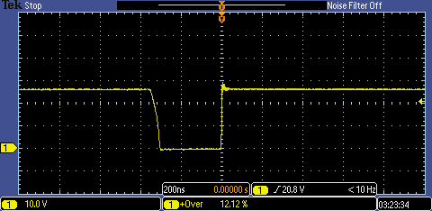

How much overshoot at V(BOOT-GND), V(SW-GND), V(BOOT-SW) ? Are you able to capture waveforms ?

Overshoot appears small, about 12% or about 3 volts, if you believe the display of the Tek MSO2024B. See attached.
