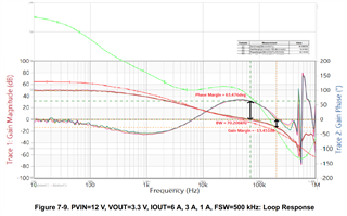

I found the loop response given in TPS7H4010EVM User's guide a bit puzzling (SNVU744 Figure 7-9 p24) :
Considering how the phase margin is taken there is no doubt on the phase offset, so i expected the phase would be around 180° when gain slope is 0 and 90° phase when gain slope is -1 which is not the case.
It looks like the average model of TPS7H4010-SEP is pretty much more inline with what i expect but it is not of much help if it does not match the actual converter :
Of course i tried to match my simulation parameters (3x47uF caps are put on Vout) :
With what is actually on the eval board :
Where is the mistake ?

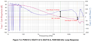

it should be also noted that the 1.8V side of the eval board have a loop response given in user's guide far closer to what i expect ( Figure 7-2 p20 ) :
Still there is a -2 gain slope in range 1k-10kHz which to me does not match a standard current mode buck converter as for example described in slup340 Figure 17 p10 :
  • erf, scales error in my measure/simulation comparison, this one is better :
    Question remains the same though.

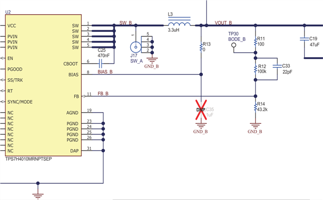

  • Hello, it looks like that it has something to do with BIAS pin which is connected by default to Vout on eval board.
    When I remove R13 and short circuit C35 footprint, TPS7H4010 internal LDO automatically takes its supply at Vin and loop response is by far closer to expected curves. This would also explain difference between 3.3 and 1.8V output as LDO switches to Vin when bias pin is below 3.3V.  There is some kind of susceptibility to low frequency through this pin, so decoupling at this level is probably trickier than expected.

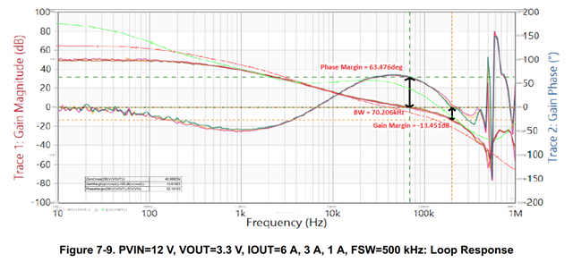

  • way better with Vbias diconnected from Vout :
    curves from 3.3V side 12Vin Iout = 3A
    My setup does not allow for relevant measure below 100Hz but trend looks ok.
    SOLVED : open loop behavior is degraded when BIAS connected to Vout
