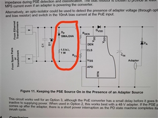

We need to use TPS23754 to make a POE and Adapter (24V, Adapter priority) power supply, and ensure that the POE can continue to power supply when the Adapter power off. We are not sure whether PSE side has the monitor function. We need to add a regulator and a resistor after PD rectification to maintain at least 10mA current.

    You are correct that the PSE side has a current sensor and needs to receive a maintain power signature (MPS) from the PD. It means the PD needs to act as a load all the time to avoid the PSE turns off the port. For AT standard, the PD could be either pulse (duty cycle > ~25%) or dc current with amplitude > 10 mA at that condition.
    In your picture, it is a DC load for MPS. It needs to meet V(adapter) - V(all oring diodes forward drop) - V (zener) > 10 mA x R. Besides, APD needs to be disabled for a hitless adapter->PoE transition.
