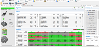

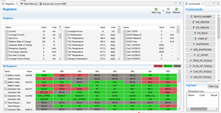

    i just changed the TS configuration , and trying to read the remaining capacity through the bqstudio , getting the response as 0x0000.
    let me know why i am getting the remianing capapcity value as 0 . when i am changing  TS2 Enable configuration  the remining cpapcity reported as zero.
    Could you please help me to find out the exact issue.

  • The full charge capacity and remianing capacity all the parameters went zero , only the chnage temperature mode changed to zero
  • Hello Mohan,
    You cannot change the gauge to use a TS pin that is not connected, it will report -273 degC which will force all gauging results (RemCap, FCC, SOC, etc) to 0 since the gauge is calculating an extremely high resistance for the cells due to the incorrect temperature input selection you have made. IF you are not using TS pins you must use the internal sensor.
