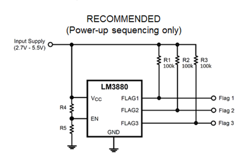

I am planning to use the below attached circuit for Power Sequencing. Can you please suggest an Enable Circuit for this?
Hi
For the EN circuity, it is really up to what you want to achieve.
If you only care the power on sequencing, you can add follow below
if you care both power on and off, the EN shall be driven external.
BTW the drawing was from Me. where did you get it?
