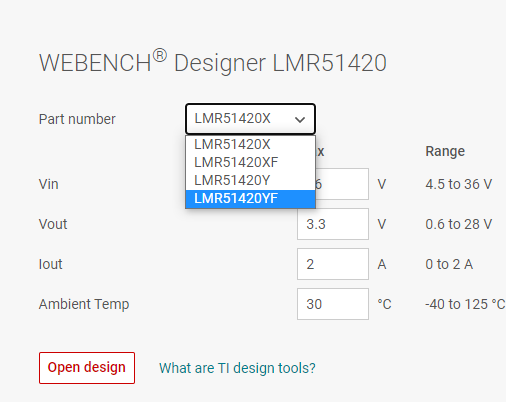

Is there a reason the "YF" version doesn't support simulation on webench? Usually we resort to pspice if this happens but I don't see a simulation model on the product page.

Hi Gui,
That is correct, but once you go to simulate the part within webench you get this error:

Your link is to the wrong parts and conditions, but your image is correct.
Our conditions are 9-30V to 3.3V at 2A. Which should be within datasheet limits and the original design compiles but can't simulate.
If you try to click "simulate" that's where we get the error.

Currently there is no 'YF' version Pspice model for LMR51420, that's also the reason the 'simulation' function cannot work. I have reached out to our business unit to see if we can develop this, but it takes time to build the Pspice model and upload.

Hi Gui,
They have an EVM and will use that for their testing but would like a simulation file long term to validate results before they go to production.
Given that there is no PSpice model for webench to use, are the passives recommendations used in webench accurate still? Or should they completely disregard the webench data?

Hi Carley
Yes customer can refer to the passives recommendations in Webench still.
