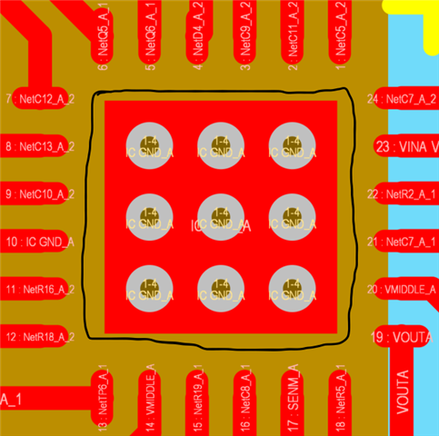

Should the thermal pad be grounded on the TPS24741?
Cory
Thanks for reaching out. The thermal pad should be connected to the device GND (PIN 10).
