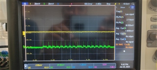

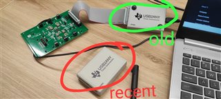

Dear TI team, I am trying to connect EVM with PI-Commander via USB2ANY but it is not getting connected. I have tried several ways mentioned in other threads. USB2ANY is detected but not EVM. I have checked SCL and SDA signals (pins 19 & 20) from 30 pin connector as well. SCL pulses are coming while clicking on Rescan Slaves but SDA is always low (zero). I have checked the connector from both sides and in both directions to confirm the signals as it is not mentioned which side should be connected to USB2ANY. Moreover, there are only 26 pins in USB2ANY but it has 30 pin connector. As I tried to check USB2ANY pins directly but there was no PIN configuration available in the document to check the signals.
Please help with the above mentioned issue.
